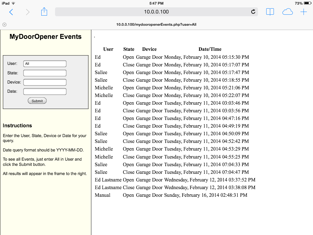

I also wanted to query this MySQL table from a web page, again using a PHP script:

Here is a screen shot of the web page:
