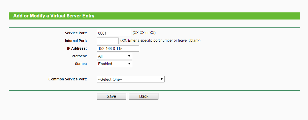

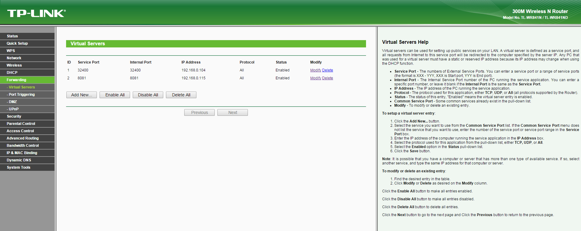

I have watched every video and read every article I could find on NAT port forwarding for my router (TpLink Model No. TL-WR841N) and they all say pretty much the same thing, to go to the Forwarding tab and click on Virtual Server and then put in the IP address and the Service port which I have done. I don't know what else to try. I've attached screen captures of the forwarding I did on my router. I set the IP address to 192.168.0.115 which is the IP address I reserved for the Arduino and I set the Service Port to 8081 as the router will not allow me to use port 80. I changed the port in the Arduino code to 8081 to match this. The Internal Port automatically got set to 8081 as well when I left that field blank. I left Common Service Port black as well as none of the articles I found on port forwarding for my router mentioned doing anything with that selection box. It has options like DNS, FTP, GOPHER, HTTP, etc. The other port forwarding rule I have set up that you see in the capture works fine, it's for my Plex media server.

Postby support » Tue Mar 08, 2016 8:39 pm
May I suggest that you first get this to work from within your internal network and then move on to having it work from the internet.
For port forwarding, it looks like you configured your external port to be 8081. So basically what this means is that you should
be able to access your Arduino using the iOS app (or browser) thru your ISP provided IP address ...
Basically, go to https://www.whatismyip.com/ and determine what your public/external IP currently is and add :8081 at the end. It should
work unless your ISP is blocking port 8081 which is a possibility.
From outside your home network, you should not be using 192.168.0.1:8081 nor 192.168.0.115:8081 but instead
use <your public/external ip>:8081. This should also work from internally but will go on the internet and back to your internal network.
This will hit your home router and port forwarding of port 8081 at your external IP will get forwarded to 192.168.0.115:8081
as per your current NAT port forwarding rules.
Again, before doing this I suggest you first get the relay working from within your internal network.
Good luck!
