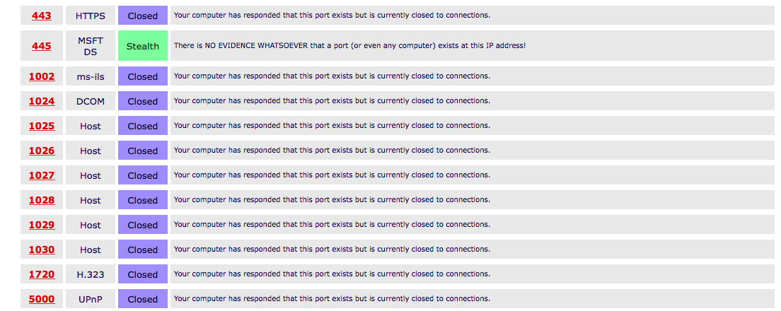

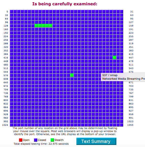

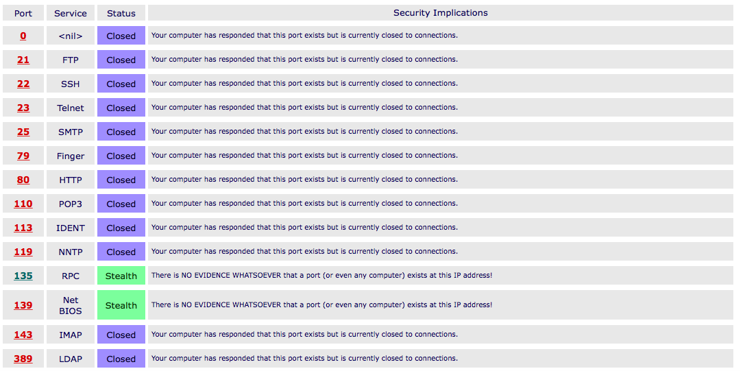

Postby gio_dude » Sat May 02, 2015 9:40 pm
thank you for your help.
turns out my isp is blocking all my ports. anything i can do to fix it other then call charter.

Postby support » Wed May 06, 2015 7:57 am
Are they blocking all ports or just the commonly used ones? Because you could use, let's say external port 8888 and have it forward to port 80 internally. Just an idea ... If that doesn't work, I really don't know what you can do but change ISP or talk them into unblocking some ports ... Good luck!
Re: Not working
Postby gio_dude » Wed May 06, 2015 9:46 am
Thanks. I'm just glad to know know I wasn't doing anything wrong.
